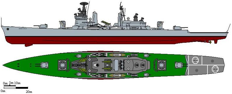

Springsharp projekt
Den svenska LV-kryssaren Äran, kölsträckt som artillerikryssare 1950, färdigställd 1962 med det amerikanska LV-robot systemet TALOS (Samma som på USS Long Beach).
OBS, Springsharp kan inte simulera robotar och deras durkar smat radarstationer osv, därför så har misc vikten nyttjas till detta.
Äran, Sweden Guided missile cruiser laid down 1950
Displacement:
7 661 t light; 7 948 t standard; 8 600 t normal; 9 121 t full load
Dimensions: Length overall / water x beam x draught
625,76 ft / 606,96 ft x 65,62 ft (Bulges 78,74 ft) x 19,69 ft (normal load)
190,73 m / 185,00 m x 20,00 m (Bulges 24,00 m) x 6,00 m
Armament:
4 - 5,98" / 152 mm guns (2x2 guns), 107,15lbs / 48,60kg shells, 1950 Model
Automatic rapid fire guns in turrets (on barbettes)
on centreline ends, evenly spread
8 - 2,24" / 57,0 mm guns (4x2 guns), 5,65lbs / 2,56kg shells, 1950 Model
on side, all amidships
8 - 1,57" / 40,0 mm guns (6 mounts), 1,95lbs / 0,89kg shells, 1950 Model
Automatic rapid fire guns in deck mounts with hoists
on side, evenly spread, all raised mounts
Weight of broadside 489 lbs / 222 kg
Shells per gun, main battery: 400
4 - 15,7" / 400 mm above water torpedoes
Armour:
- Belts: Width (max) Length (avg) Height (avg)
Main: 2,95" / 75 mm 328,08 ft / 100,00 m 9,22 ft / 2,81 m
Ends: 0,39" / 10 mm 65,62 ft / 20,00 m 9,22 ft / 2,81 m
213,25 ft / 65,00 m Unarmoured ends
Upper: 0,39" / 10 mm 362,53 ft / 110,50 m 8,01 ft / 2,44 m
Main Belt covers 83 % of normal length
- Gun armour: Face (max) Other gunhouse (avg) Barbette/hoist (max)
Main: 1,97" / 50 mm 1,18" / 30 mm 1,97" / 50 mm
2nd: 0,98" / 25 mm 0,39" / 10 mm 0,98" / 25 mm
3rd: 0,20" / 5 mm 0,08" / 2 mm 0,20" / 5 mm
- Armour deck: 1,18" / 30 mm, Conning tower: 1,97" / 50 mm
Machinery:
Oil fired boilers, steam turbines,
geared drive, 2 shafts, 67 604 shp / 50 432 Kw = 33,00 kts
Range 6 000nm at 16,00 kts
Bunker at max displacement = 1 173 tons
Complement:
446 - 580
Cost:
£4,349 million / $17,395 million
Distribution of weights at normal displacement:
Armament: 73 tons, 0,9 %
Armour: 1 100 tons, 12,8 %
- Belts: 438 tons, 5,1 %
- Torpedo bulkhead: 0 tons, 0,0 %
- Armament: 86 tons, 1,0 %
- Armour Deck: 559 tons, 6,5 %
- Conning Tower: 18 tons, 0,2 %
Machinery: 1 617 tons, 18,8 %
Hull, fittings & equipment: 3 895 tons, 45,3 %
Fuel, ammunition & stores: 939 tons, 10,9 %
Miscellaneous weights: 975 tons, 11,3 %
Overall survivability and seakeeping ability:
Survivability (Non-critical penetrating hits needed to sink ship):
15 915 lbs / 7 219 Kg = 148,5 x 6,0 " / 152 mm shells or 2,5 torpedoes
Stability (Unstable if below 1.00): 1,29
Metacentric height 4,2 ft / 1,3 m
Roll period: 16,2 seconds
Steadiness - As gun platform (Average = 50 %): 62 %
- Recoil effect (Restricted arc if above 1.00): 0,05
Seaboat quality (Average = 1.00): 1,24
Hull form characteristics:
Hull has raised forecastle, low quarterdeck
and transom stern
Block coefficient: 0,320
Length to Beam Ratio: 7,71 : 1
'Natural speed' for length: 29,66 kts
Power going to wave formation at top speed: 53 %
Trim (Max stability = 0, Max steadiness = 100): 50
Bow angle (Positive = bow angles forward): 25,00 degrees
Stern overhang: 6,56 ft / 2,00 m
Freeboard (% = measuring location as a percentage of overall length):
- Stem: 26,25 ft / 8,00 m
- Forecastle (20 %): 24,61 ft / 7,50 m (22,97 ft / 7,00 m aft of break)
- Mid (50 %): 19,69 ft / 6,00 m
- Quarterdeck (15 %): 9,84 ft / 3,00 m (16,40 ft / 5,00 m before break)
- Stern: 9,84 ft / 3,00 m
- Average freeboard: 19,24 ft / 5,87 m
Ship tends to be wet forward
Ship space, strength and comments:
Space - Hull below water (magazines/engines, low = better): 81,4 %
- Above water (accommodation/working, high = better): 205,2 %
Waterplane Area: 25 561 Square feet or 2 375 Square metres
Displacement factor (Displacement / loading): 146 %
Structure weight / hull surface area: 103 lbs/sq ft or 504 Kg/sq metre
Hull strength (Relative):
- Cross-sectional: 0,95
- Longitudinal: 1,53
- Overall: 1,00
Hull space for machinery, storage, compartmentation is excellent
Room for accommodation and workspaces is excellent
Good seaboat, rides out heavy weather easily
2x2 rails for Talos SAM (32 missles)
1x2 rails for Rb 08 SSM (8 missles)
Pad for 2 Helicopters, no hangar

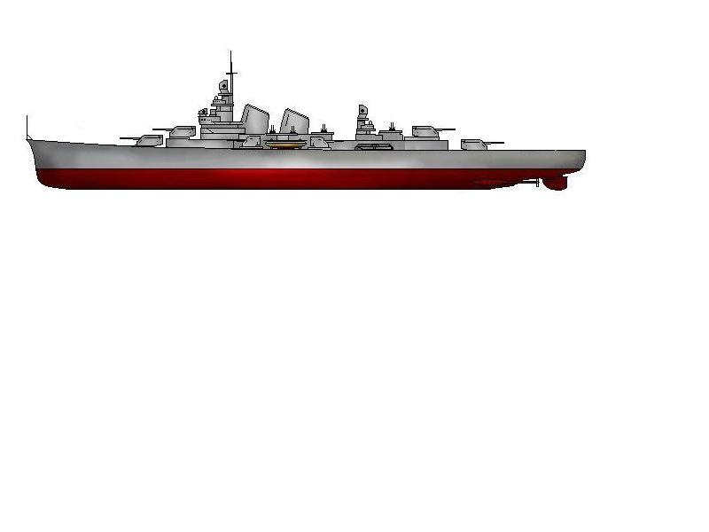

Jag har försökt simulera ett modernt fartyg, för att simulera CODAG maskineri har jag endast monterat dieslar i SS samt misc för FT (samt vapen system och sensorer), behovet av SHP beräknade jag genom att pressa upp fartyget i tänkt maxfart samt sedan se behovet och beräkna gasturbinernas antal.
Har inte riktigt hittat var jag skall stoppa in volymen för mk41 VLS systemet.
Svärdet, Sweden CGH Laid down 1986
Displacement:
6 673 t light; 6 873 t standard; 8 000 t normal; 8 901 t full load
591,46 ft / 574,15 ft x 65,62 ft x 19,69 ft (normal load)
180,28 m / 175,00 m x 20,00 m x 6,00 m
Armament:
3 - 5,98" / 152 mm guns (1x3 guns), 107,15lbs / 48,60kg shells, 1950 Model
Automatic rapid fire guns in a turret (on a barbette)
on centreline forward
4 - 2,24" / 57,0 mm guns in single mounts, 5,65lbs / 2,56kg shells, 1950 Model
4 - 1,18" / 30,0 mm guns in single mounts, 0,82lbs / 0,37kg shells, 1950 Model
Weight of broadside 347 lbs / 158 kg
Shells per gun, main battery: 200
6 - 15,7" / 400 mm above water torpedoes
2x MK41 VLS (424m3, 54m2 each, 2x250ton)
122 missiles
8x rbs 15 SSM
Sensors: 1x AN SPS 48/E - PS 860 (airsearch)
1x SeaGiraffe 50HC (air/surf search)
1x BAE Type 996 (air/surf search)
2x Raccal Decca (Nav)
4x Ericsson 9lv Mk2 FC (gun)
4x SPG-62 FC radar (missile)
Aircraft: 2x HKP4 - Boeing Vertol Seaknight
Armour:
Main: 1,97" / 50 mm 328,08 ft / 100,00 m 9,71 ft / 2,96 m
Ends: Unarmoured
Main Belt covers 88 % of normal length
Main: 1,18" / 30 mm 0,79" / 20 mm 1,18" / 30 mm
2nd: 0,39" / 10 mm 0,20" / 5 mm 0,20" / 5 mm
- Armour deck: 0,79" / 20 mm, Conning tower: 1,97" / 50 mm
Machinery: Combined Diesel and gasturbine
3x R & R Olympus Gasturbines 25000shp
Diesel Internal combustion motors,
Displacement:
Armament:
122 missiles
8x rbs 15 SSM
Armour:
Ends: Unarmoured
Geared drive, 3 shafts, 12 367 shp / 9 226 Kw = 20,00 kts
CoDaG = 12400shp + 70000shp = 82400shp (72000shp demanded)
Range 8 000nm (diesel) at 18,00 kts
top speed 32 kts (CoDAG)
Bunker at max displacement = 2 028 tons
Complement:
422 - 549
Cost:
£2,492 million / $9,968 million
Armament: 52 tons, 0,7 %
Armour: 646 tons, 8,1 %
- Belts: 268 tons, 3,3 %
- Armament: 27 tons, 0,3 %
- Armour Deck: 334 tons, 4,2 %
- Conning Tower: 17 tons, 0,2 %
Machinery: 296 tons, 3,7 %
Hull, fittings & equipment: 3 159 tons, 39,5 %
Fuel, ammunition & stores: 1 327 tons, 16,6 %
Miscellaneous weights: 2 520 tons, 31,5 %
21 239 lbs / 9 634 Kg = 198,2 x 6,0 " / 152 mm shells or 3,5 torpedoes
Stability (Unstable if below 1.00): 1,01
Metacentric height 2,7 ft / 0,8 m
Roll period: 16,8 seconds
Steadiness - As gun platform (Average = 50 %): 89 %
- Recoil effect (Restricted arc if above 1.00): 0,11
Seaboat quality (Average = 1.00): 1,78
Hull has raised forecastle, rise forward of midbreak, low quarterdeck
Block coefficient: 0,378
Length to Beam Ratio: 8,75 : 1
'Natural speed' for length: 23,96 kts
Power going to wave formation at top speed: 29 %
Bow angle (Positive = bow angles forward): 20,00 degrees
- Stem: 29,53 ft / 9,00 m
- Forecastle (20 %): 26,25 ft / 8,00 m (22,97 ft / 7,00 m aft of break)
- Mid (50 %): 22,97 ft / 7,00 m (19,69 ft / 6,00 m aft of break)
- Quarterdeck (30 %): 8,86 ft / 2,70 m (19,69 ft / 6,00 m before break)
- Stern: 8,86 ft / 2,70 m
- Average freeboard: 19,00 ft / 5,79 m
Space - Hull below water (magazines/engines, low = better): 52,4 %
- Above water (accommodation/working, high = better): 210,5 %
Waterplane Area: 22 950 Square feet or 2 132 Square metres
Displacement factor (Displacement / loading): 192 %
Structure weight / hull surface area: 90 lbs/sq ft or 442 Kg/sq metre
- Longitudinal: 1,51
- Overall: 1,00
Ship has slow, easy roll, a good, steady gun platform
Excellent seaboat, comfortable, can fire her guns in the heaviest weather
top speed 32 kts
sensors

Ny kryssare, ersättare till de föråldrade Äran båtarna från tidigt 60-tal, har försökt få in erfarenheter från Falklandskriget.
HMS Svärdet
HMS Svärdet, Sweden CGH laid down 1950
Displacement:
6 682 t light; 6 882 t standard; 8 009 t normal; 8 911 t full load
Armament:
Armour:
Ends: Unarmoured
Machinery:
Geared drive, 3 shafts, 12 376 shp / 9 233 Kw = 20,00 kts
Range 8 000nm at 18,00 kts
Bunker at max displacement = 2 030 tons
Complement:
423 - 550
Cost:
£2,495 million / $9,978 million
Hull, fittings & equipment: 3 167 tons, 39,5 %
Fuel, ammunition & stores: 1 328 tons, 16,6 %
21 290 lbs / 9 657 Kg = 198,7 x 6,0 " / 152 mm shells or 3,5 torpedoes
- Above water (accommodation/working, high = better): 210,0 %
Waterplane Area: 22 954 Square feet or 2 132 Square metres
Structure weight / hull surface area: 91 lbs/sq ft or 443 Kg/sq metre
- Cross-sectional: 0,96
- Overall: 1,00
top speed 32 kts
122 missiles
8x rbs 15 canisters
1x2 RBS 08 SLCM launcher (12missiles)
sensors
HMS Svärdet

Mina senaste uppdateringar, några har passerat här, men kunde kanske vara kul att se dem
Snapphanen ASW destroyer
Kung Karl LSD
Älvsnabben Aviationsupport ship

Jag har tagit mig friheten att modifiera din Huginklass till vanlig lätt kryssare.
Allt inom flygväg är borttaget och ev fjärde dubbel15 har tillkommit.
Dessutom har A och B-tornen plus överbyggnaden flyttats akteröver
Torpeder och aktre avståndsmätare har tillkommit
Hälsningar //dc
Hälsningar //dc
