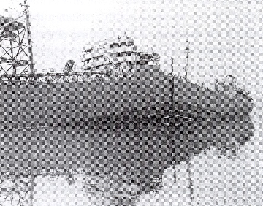

Inlägg av Sarvi » 6 januari 2020, 14:15
Det var ju ett antal skepp i de hektiska fartygsbyggnadsprogrammen som hade liknande problem, men det där är nog det mest publika fallet, SS Schenectady i Portland:
On 16 January 1943, she was moored at the fitting dock at Swan Island, in calm weather, shortly after returning from her sea trials. Without warning, and with a noise audible for at least a mile, the hull cracked almost in half, just aft of the superstructure. The cracks reached down the port and starboard sides almost to the keel, which itself fractured, jackknifing upwards out of the water as the bow and stern sagged to the bottom of the river. Only the bottom plates of the ship held.
https://en.m.wikipedia.org/wiki/SS_Schenectady
Orsaken är fortfarande omdiskuterad, men dålig svetsteknik, undermåligt (skört) stål och ogynnsam konstruktion (räta vinklar på t.ex. lastluckor) som fungerade som sprickanvisningar var alla troligen bidragande.

Inlägg av varjag » 6 januari 2020, 22:35
av StefanZ » mån jan 06, 2020 9:01 pm
Jänkarna var tydligen duktiga på fartygsreparationer.
On 16 January 1943, she was moored at the fitting dock at Swan Island, in calm weather, shortly after returning from her sea trials. Without warning, and with a noise audible for at least a mile, the hull cracked almost in half, just aft of the superstructure. The cracks reached down the port and starboard sides almost to the keel, which itself fractured, jackknifing upwards out of the water as the bow and stern sagged to the bottom of the river. Only the bottom plates of the ship held. This was not the first of the war-built merchant fleet to fracture in this way – there had been ten other major incidents, and several more would follow – but it was perhaps the most prominent; it occurred in full view of the city of Portland, and was widely reported in the newspapers even under wartime conditions.
The cause of the fracture was not fully understood at the time; the official Coast Guard report gave the cause of failure as faulty welding, while the Board of Investigation considered factors as diverse as "locked-in" stresses, sharp changes in climate, or systemic design flaws. Defective welding became the most common explanation for these incidents, especially when later investigations uncovered faulty working practices at some yards, but even then it could only be clearly identified as the case in under half of all major fracture cases. Later research indicated that the failure method was probably a brittle fracture, caused by low-grade steel.
T2-tankbåtarna - det byggdes mer än 500 av dom - hade fortsatta problem av samma sort;
Marine Board of Investigation in 1952 stated that in cold weather the ships were prone to metal fatigue cracking, so were "belted" with steel straps. This occurred after two T2s, Pendleton and Fort Mercer, split in two off Cape Cod within hours of each other. Pendleton's sinking is memorialized in The Finest Hours.[1] Engineering inquiries into the problem suggested the cause was poor welding techniques. It was found the steel (that had been successfully used in riveted ship design) was not well suited for the new wartime welding construction. The high sulfur content made the steel brittle and prone to metal fatigue at lower temperatures
